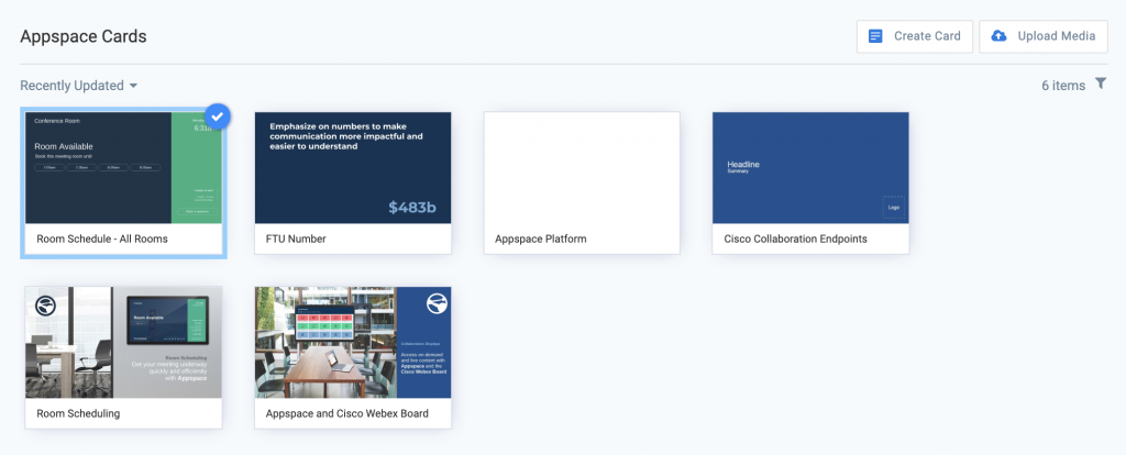

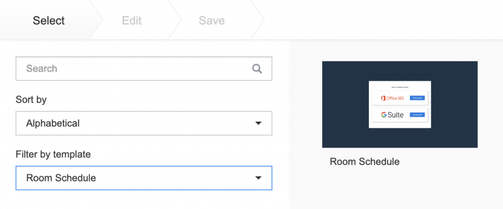

Create a new card with the Room Schedule template
In the console, select Create Card from the Quick Action menu. To quickly locate the Room Schedule card, select Room Schedule from the Filter by template dropdown.

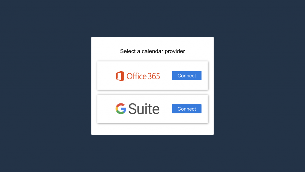

Select the G Suite option and enter credentials
If you have not done so already, please contact your IT administrator for credentials. Enter your booking account credentials to authenticate the Room Schedule card.

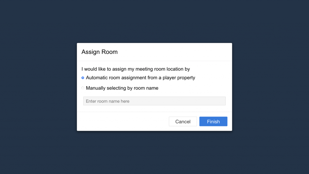

Automatic room assignment
This is the option we recommend as it allows you to use the same card (with the defined configuration and branding themes) for multiple rooms.
You must then add a device property to each device and ensure it points to the desired meeting room, where you will have one specific tablet for each meeting room.

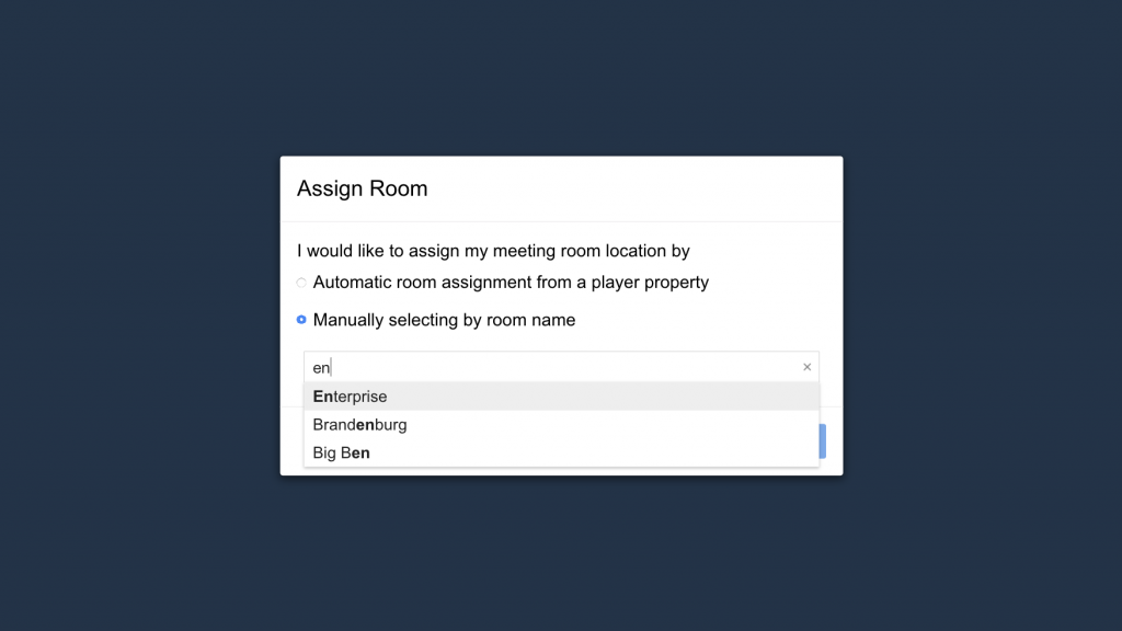

Option for manual room assignment
If you prefer to assign a specific Room Schedule card and channel per device, then you can select the manual room assignment option. The calendar provider will return a list of selectable rooms, and you will need to choose one.
With the manual room assignment option, this means that if you have 10 rooms, you must create 10 cards for each room.

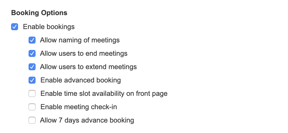

Check the option to Enable bookings to configure room booking options that can be made available to people. Room booking options include:
- Allow naming of meetings
- Allow users to end meetings
- Allow users to extend meetings
- Enable advanced booking
- Enable time slot availability on front page
- Enable meeting check-in
- Allow 7 days advance booking.

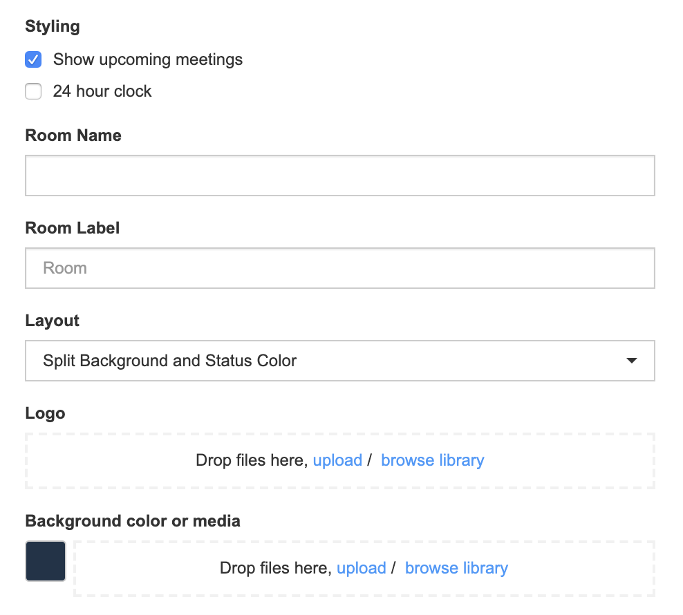

Additional styling options
Under the Styling section, you can check the option to Show upcoming meetings to display upcoming meetings of the day. To display the time in 24 hour format, check the option for the 24 hour clock.
You can also stylize the card further with the following options and components:
- Room Name
- Room Label
- Layout
- Logo
- Background color or media
- Background Mask Color
- Available State Color
- Occupied State Color

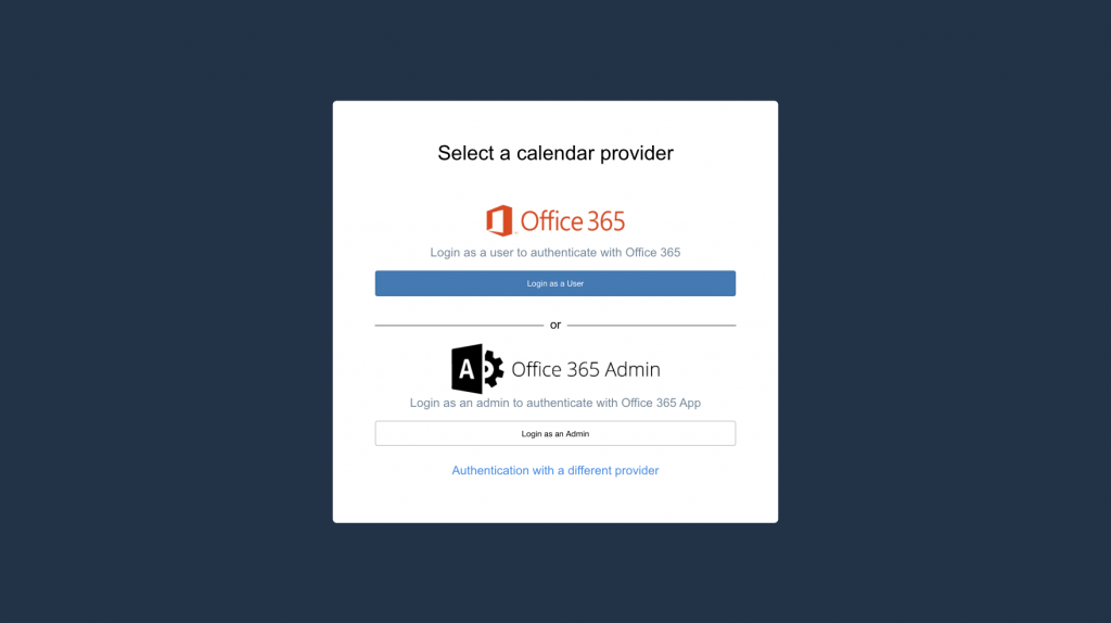

Select the Office 365 option and enter credentials
If you have not done so already, please contact your IT administrator for credentials. Some large organizations may have one account for each room.
Select the appropriate authentication depending on your booking account type.
Configure booking options
- Room Name
- Room Label
- Layout
- Logo

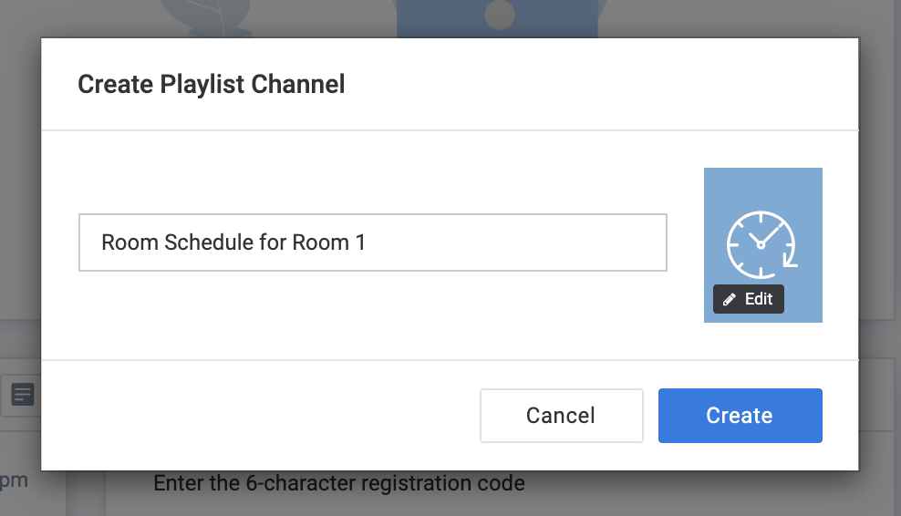

Create a new channel for the Room Schedule card
Create a new channel by clicking on Create Channel from the Quick Action menu. This channel will contain only a single item which will be the Room Schedule card that you have configured. Since it will only contain this single item, you can give a name that best describes the function of the channel such as Room Schedule for Room 1. You can also select a custom icon to make it easy to identify the channel for assignment.

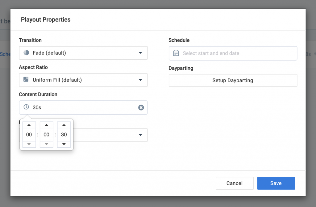

Set the content duration for the Room Schedule card
As your channel will only have a single Room Schedule card, we recommend setting the content duration to a minimum of 30 seconds instead of the default value of 8 seconds. This ensures that the channel does not keep reloading the card while someone is in the process of booking the room. Click on Apply to confirm your settings.

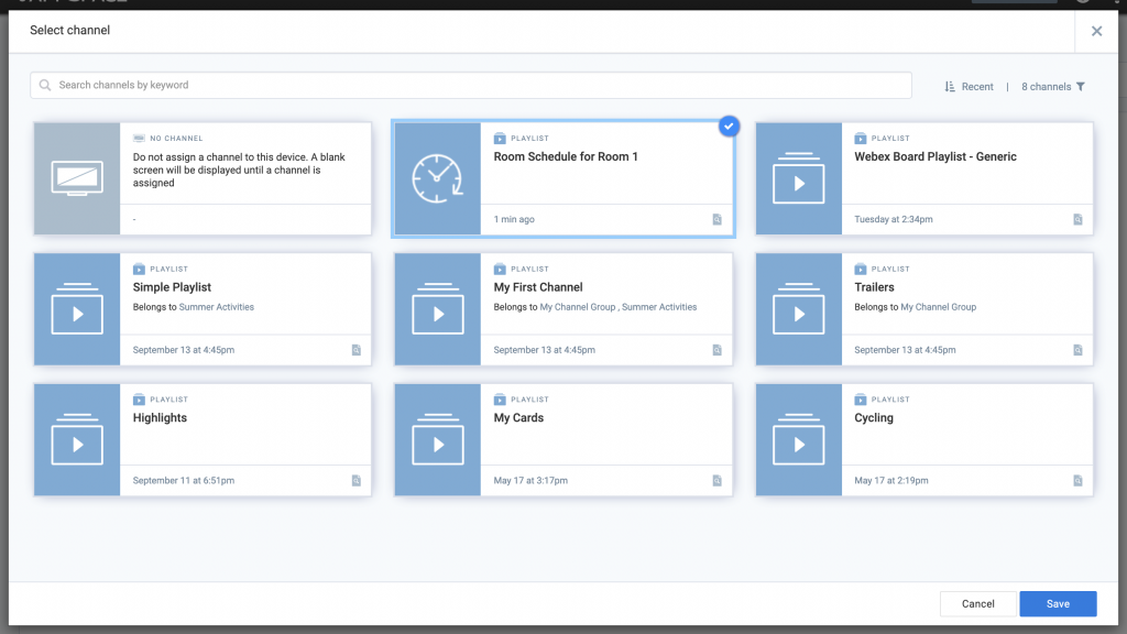

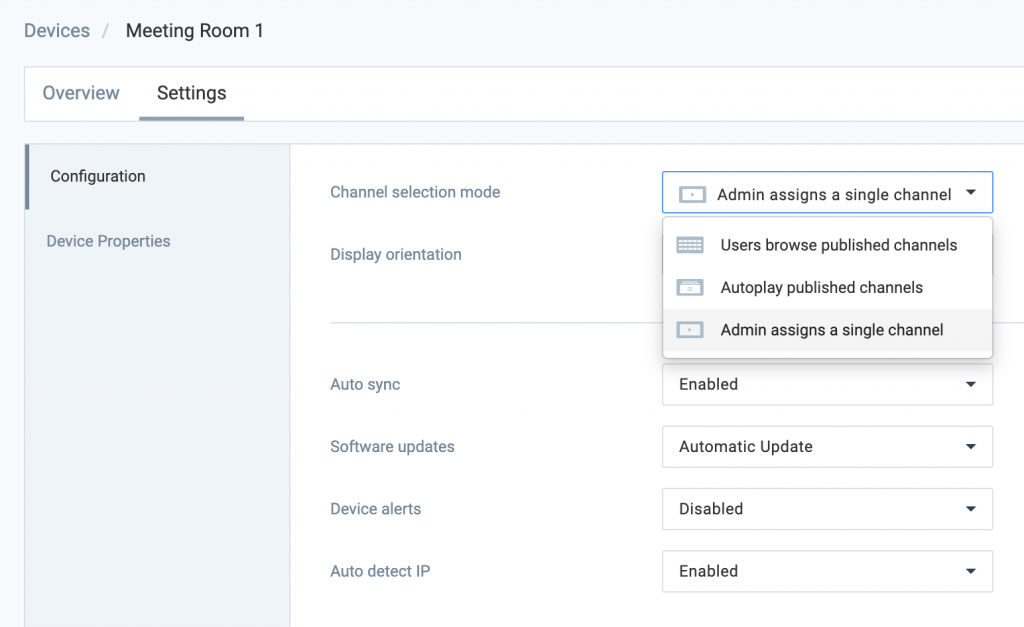

With the channel ready, you will then need to assign the channel to your target device. Go to the Devices workflow and select the device from the list to do the channel assignment.
Selecting the device will launch the Device Information overlay. Click on the Settings tab and select Admin assigns a single channel from the Channel selection mode dropdown. Click on Save to apply the settings.
Set the channel assignment for the device
Click on the Overview tab and you will now see the option to select a channel for this device. Click on the Select channel button and select the Room Schedule channel you created and then click on Save to confirm the channel assignment.
Once the settings take effect, the device will automatically show the appropriate details for the room. You are now ready to book meetings!
