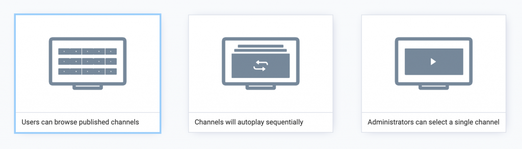

Set the channel selection mode
Click on the Channel Selection Mode field and select the option that matches your digital signage requirements:
  • If you are using only one playlist channel for both display modes (Background and Standby), select Administrators can select a single channel and choose which channel to use..
  • If you are using two different playlist channels for each display mode, select Users can browse published channels.
