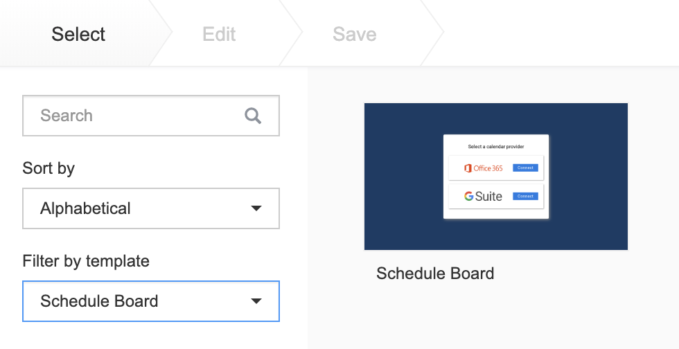

In the console, select Create Card from the Quick Action menu. To quickly locate the Room Schedule card, select Schedule Board from the Filter by template dropdown.
Select a calendar provider and enter credentials
If you have not done so already, please contact your IT administrator for credentials. Enter your booking account credentials to authenticate the Schedule Board card.

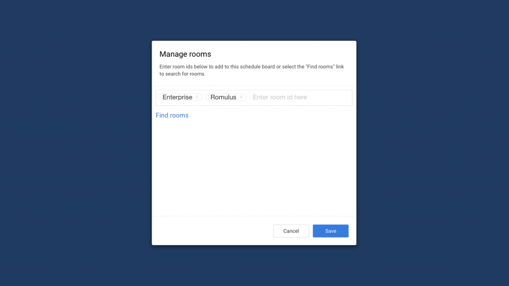

Once authentication is successful, you can select which rooms you want to display on the Schedule Board. You can enter the room ids directly into the input field, or you can click on Find rooms to search for the desired room to add from the calendar provider.
Click on Save once your room selection is complete and the rooms will be added to the Schedule Board card.

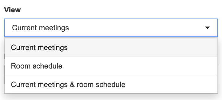

Select a view option
Select a View option from the drop-down menu to display how the room information will be displayed.
- Current meetings – This view shows the current meetings that are happening. Rooms that do not have any current meetings will be shown as available.
- Room schedule – This shows a timeline view of all room schedules, starting from the current time to a few hours ahead.
- Current meetings & room schedule – This allows you to switch between both views, and is best used for an interactive screen.

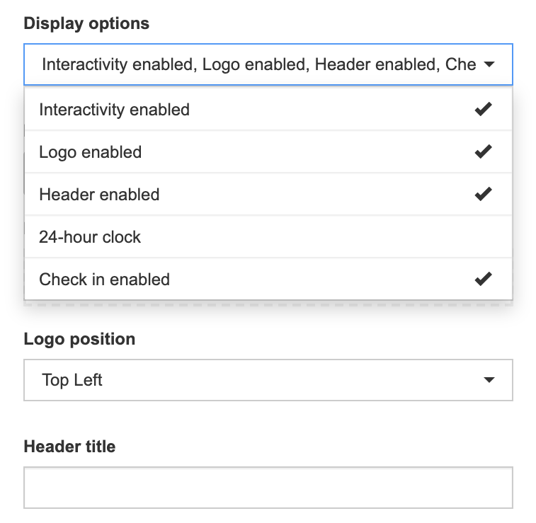

You can also choose which Display options should be shown on the Schedule Board. By default, all options are enabled with the exception of the 24-hour clock.
Display options include:
- Interactivity enabled
- Logo enabled
- Header enabled
- 24-hour clock
- Check in enabled
You can also specify the position of your logo, and also provide your own custom Header title if you want to override the default title that is displayed for the Schedule Board card.

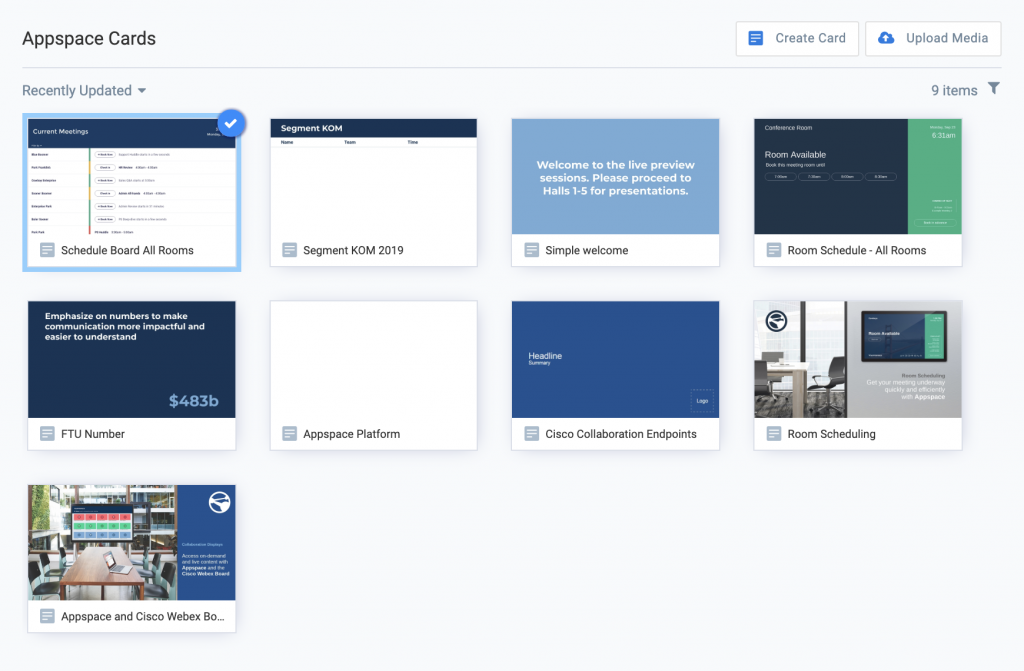

Once you have finished configuring all of the Room Schedule details, click on Next to finish the card creation process. Give your card a title, and make sure that you are saving the card to the folder and library location of your choice. Click on Save to complete.

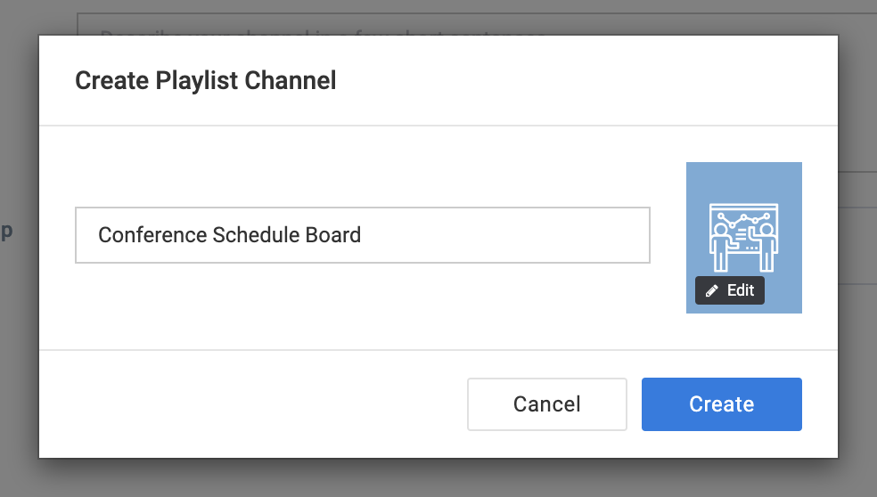

Create a new channel by clicking on Create Channel from the Quick Action menu. This channel will contain only a single item which will be the Room Schedule card that you have configured. Since it will only contain this single item, you can give a name that best describes the function of the channel such as Conference Schedule Board. You can also select a custom icon to make it easy to identify the channel for assignment.

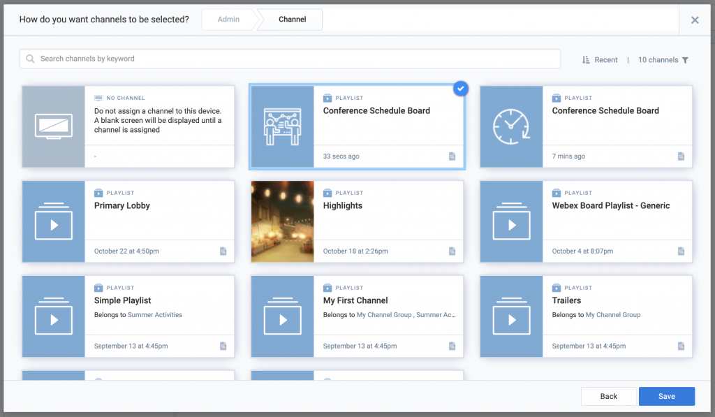

Click on the Overview tab and you will now see the option to select a channel for this device. Click on the Select channel button and select the Schedule Board channel you created and then click on Save to confirm the channel assignment.
Once the settings take effect, the device will automatically show the appropriate details for all the rooms. You are now also ready to book meetings!
