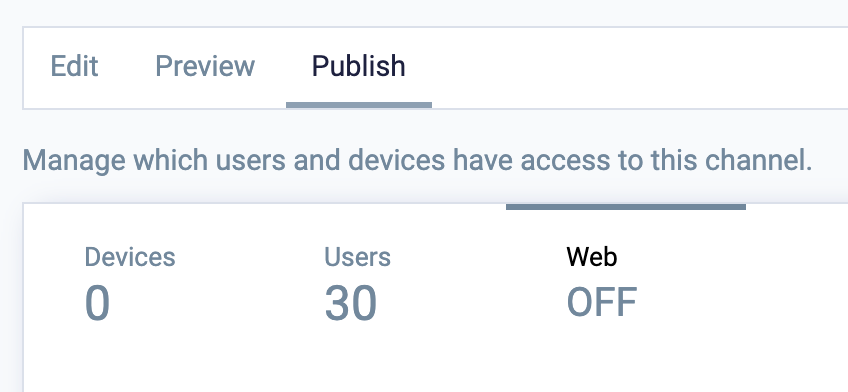

Select the channel that you want to publish
Select a channel that you have access to and click on the Publish tab and the Web sub tab to start the publishing process.

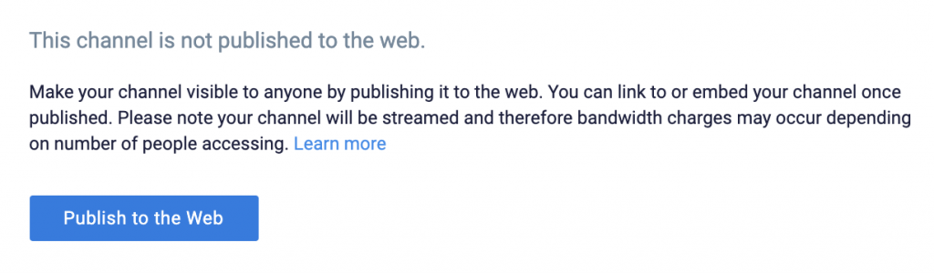

Enable Publish to the Web
Click on the Publish to the Web button to make the channel become available for web publishing. Please note that when a channel is published to the web, the channel will be streamed and therefore bandwidth charges will apply.

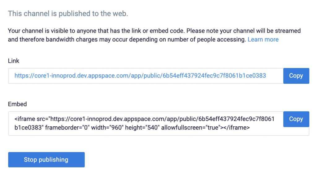

Copy the channel URL
When a channel is first published to the web, it will take a minute or two for the channel content to be initialized. Once initialized, the channel will be publicly viewable through a static URL.
You can use the Link URL to view the channel directly in a browser, or use the Embed URL to display the channel inside a web page.
3
View the channel
Simply copy+paste the Link URL into any browser to view the published channel. You can also enter the Link or Embed URL into your organization’s intranet website or even your own website if you wish to show the published channel there.
However, do note that when the channel is being viewed on the web, bandwidth charges will apply.
