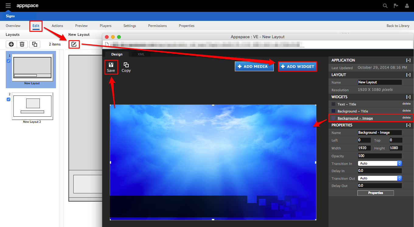

  1. From the Signs extension, select the app you wish to perform media zone linking to. Click the Edit tab, select the layout and click the Visual Editor button. Add a media zone widget to the layout and click Save.
  2. As a best practice, ensure the exact same values are entered in the target application for each individual widget in their respective PROPERTIES section of the Visual Editor. This prevents any inconsistencies in the position and size of the widgets from the source application.
